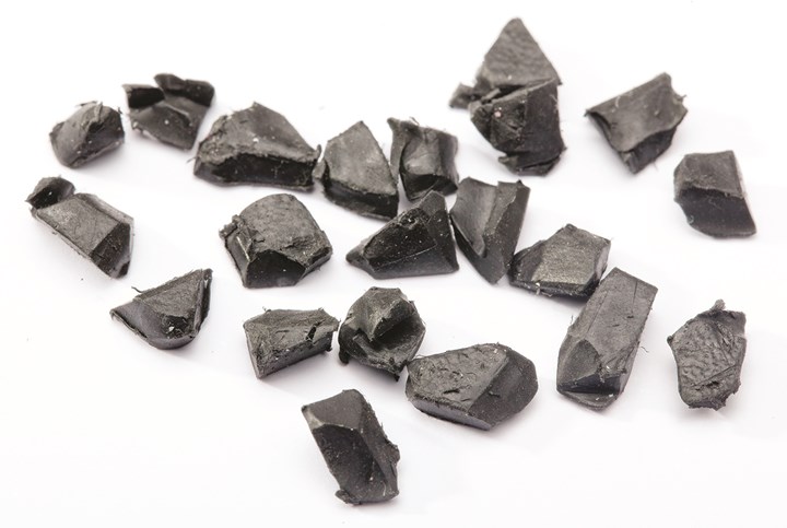

Good quality granulated material.
Regrind is considered good when it is free from dust/fines and of uniform size

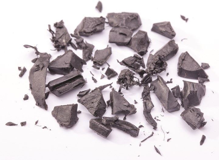

Poor quality granulated material.
Bad regrind has excessive dust/fines and is non-uniform in size.

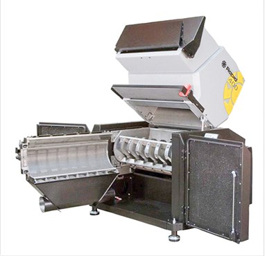

Today, most leading granulator manufacturers realize that with the increasing cost of materials and shrinking maintenance budgets, it’s important that granulators be designed for easy cleaning and knife maintenance. Quick and safe access to the heart of the granulator is critical for optimal productivity.
Granulator with access panels open
Granulators today are generally designed with maintenance in mind, offering safe and easy access to the heart of the unit.
Think about a processor running multiple colors and materials in short-run production cycles, who needs to clean the machine thoroughly between each run to avoid contamination. The granulator must be designed to allow the operator to visibly confirm that the machine is clean while ensuring that the operator is safe when inside the machine. That is, the granulator should have redundant safety switches for maximum safety and should have features such as power-assisted tilt-back hoppers, rotor locking devices, and easily accessible and removable screen cradles and screens. Visibly clean means the operator should have visual paths to all areas of the machine—no hidden nooks and crannies—to inspect and confirm the machine is free from all previous colors or materials that may lead to contamination in the next run.

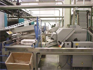

Just as it’s better to remove regrind automatically from your granulator with an appropriately sized evacuation system, it’s also better to automatically meter-feed your granulator—either with a robot or a conveyor. That way, there is no chance of over-feeding your unit.
Inline granulation system featuring roll-feed.
It’s best to automatically meter-feed your granulator—either with a robot or a conveyer. Shown here is a well-designed inline granulation system featuring roll-feed and an evacuation system.
