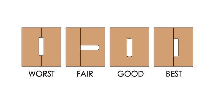

There are four common methods of installing an ejector blade in a mold, as shown in Fig. 3.  The worst method is when a portion of the blade rides in more than one mold component.  The odds of perfectly aligning the machined slots are slim to none.  This will cause accelerated wear and down-flash.  Another method is to install the entire width of the blade in one component.  While this is an acceptable method, it is difficult to repair.  It cannot be welded, but it can be ground or wire EDM-ed to a larger size.
Blade Ejectors in Molds
FIG 3 Four common methods of installing an ejector blade.
A very common method of installing ejector blades is in a wire-EDM hole.  This is a fast and relatively inexpensive method, but again, not an easy method to repair.  One advantage to this method is that a fine EDM finish is sufficient to retain a very thin film of lubricant, which helps reduce the rate of wear. The best method is to machine a wide but shallow slot in one mold component. This type of installation is the easiest to repair if it wears. It is also the easiest to adjust the clearance to get good venting without any down-flash.

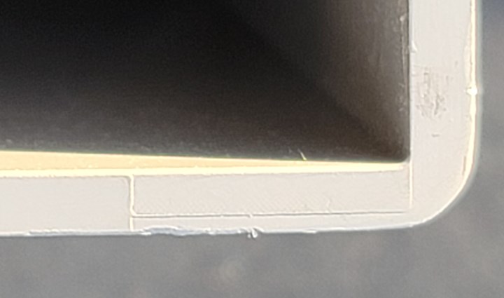

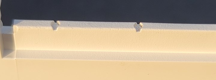

Despite what you may believe, have read or been taught, an ejector blade should never be flush with the edge of a rib or a part. Figure 4 is an example of a poorly located blade. It should be set back a minimum of 0.005 in. from any edge or corner. There are three reasons for this. The first is that you want a small amount of plastic to be in a blind corner. This helps prevent down-flash. The second reason is that if the ejector blade is even slightly bent or deflects to the side during ejection, you don’t want the sharp edge of the blade scraping against the side of the core. The third reason is that it is easier for a toolmaker to take a measurement from a small step than it is from a smooth transition.

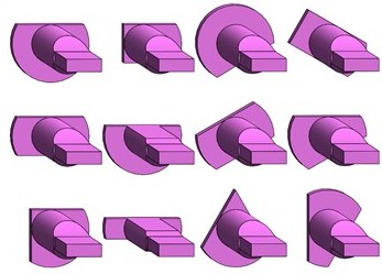

Unless there is a special contour machined into the face of a blade ejector, most mold designers don’t feel it is necessary for the heads to be keyed or oriented. They assume the blade is self-aligning. While that may be true, why would you want the surfaces of the blade, which are subject to wear, to be responsible for its alignment? The Japanese understand this and offer various contoured head styles as standards, as in Fig. 5. Additionally, any mold with ejector blades should be guided. Heavy, sagging ejector plates cause the pins, sleeves and blades to be misaligned and prematurely wear or gall.
