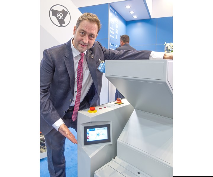

Mark Hellweg, managing director, shows off the new GRANUmaster smart control.
“Who would pay for this?” I thought to myself. “Does anyone really need a ‘talky’ granulator?” And when I asked another supplier of granulators and other auxiliary equipment, that source said that, despite his company’s overall commitment to Industry 4.0, granulators are too price-sensitive a market to support such PhD-level “smarts.”
So I hiked over to the booth of Hellweg Maschinenbau, the German granulator maker, and posed my questions to the first person I could collar. That turned out to be Mark Hellweg, the managing director. I told him that his new controls sounded impressive, but “Is anyone buying them?”. He replied that he had sold a double-digit number of those “smart” models right there at the show. With animated enthusiasm, he proceeded to tell me why.
He started with the ability to program the GRANUmaster smart control touchscreen with specific rpm and torque values for a particular material or part. There’s also an “eco” operating mode, in which the control measures the power consumption over time and “learns” how to apply the optimum settings—worth up to 40% energy savings, according to Hellweg. As noted in the January K Show report on recycling and scrap reclaim by my colleague, Senior Editor Heather Caliendo, users of these new Hellweg machines can select various rotation speeds, so that even very low-melting plastics can be granulated without need for additional cooling. And there’s a “boost” mode to temporarily increase grinding capacity to accommodate fluctuations in demand. This new control is available on all Hellweg granulators from the 2-5 hp, beside-the-press 150 Series on up.
As Heather’s article noted, and Mr. Hellweg was eager to point out, these smart controls record a variety of operating data useful for preventive maintenance: power consumption, rotational speeds, bearing temperatures, and operating hours of bearings, blades, screens and drive belts. This data can be communicated to a central computer via the OPC-UA interface included as standard (the basis of contemporary Industry 4.0 systems). The granulator also can be monitored remotely and can be networked to communicate with upstream and downstream components. What’s more, the granulator controller can be used to issue spare-parts requests and even automatic requests for parts that wear out on a regular basis.
Hellweg also pointed to features such as soft start, safe shutdown (fast stop), V-belt fire monitoring with emergency shutdown, and warning lights when maintenance is required. “I sell safety,” Hellweg stated.
One feature reportedly prized by customers is integration of a full manual into the controls, with step-by-step maintenance instructions.
He was also particularly proud of the inclusion of a complete illustrated manual within the controller, which offers step-by-step instructions for cleaning, blade changing and V-belt maintenance, as well as instructions for general maintenance and visual inspection. Hellweg said this feature definitely contributed to sales of the new controls.
