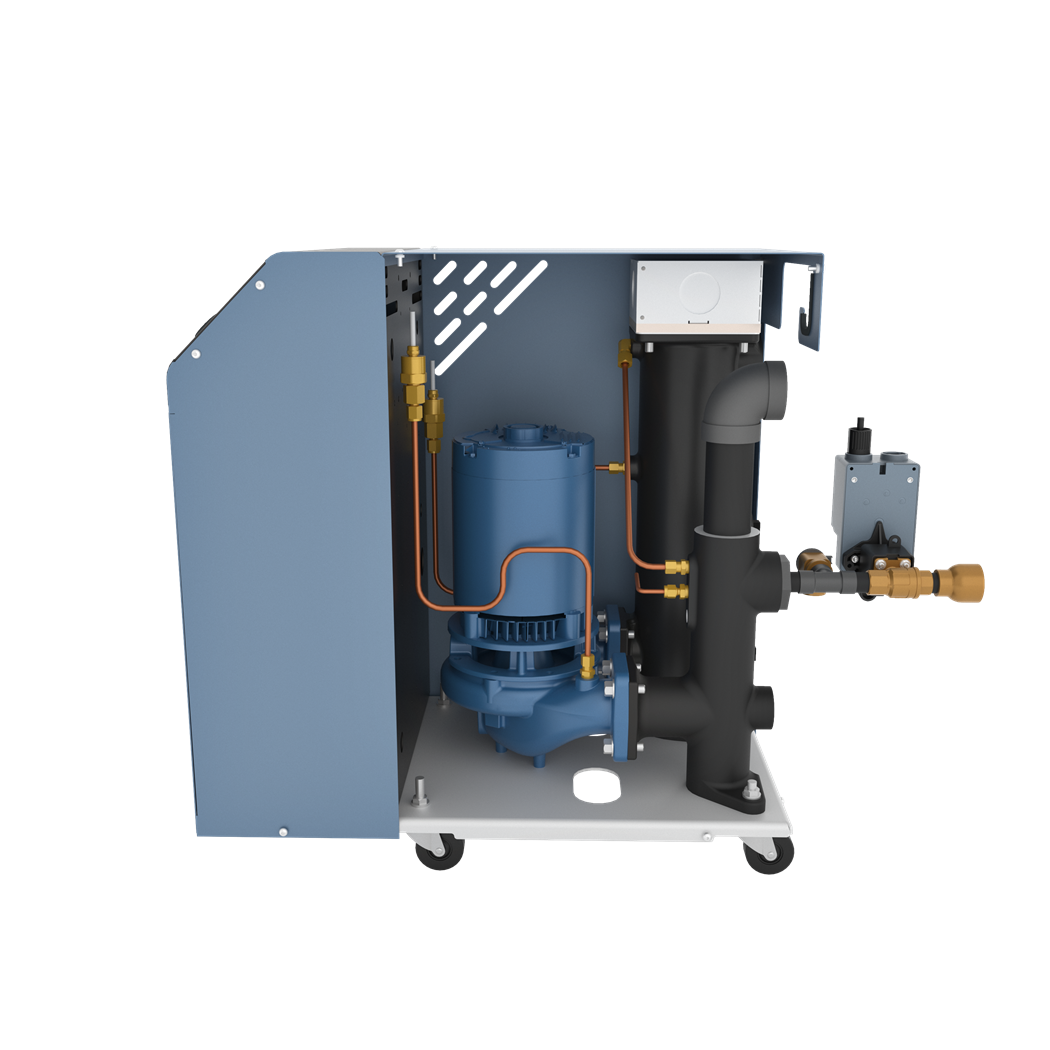

A temperature control unit, or TCU as it is commonly known, has two major components: the pump and the heater. Both are managed by a programmable logic controller (PLC).
During operation, a temperature setpoint is input into the controller. The pump continually circulates a fluid — most commonly water — from the TCU to the process and then back to the TCU. This is referred to as the temperature control loop or process loop. While the fluid is circulated through this loop, the controller will monitor input from a temperature sensor on the TCU’s return line.

This typical TCU shows the pump and heater tube.

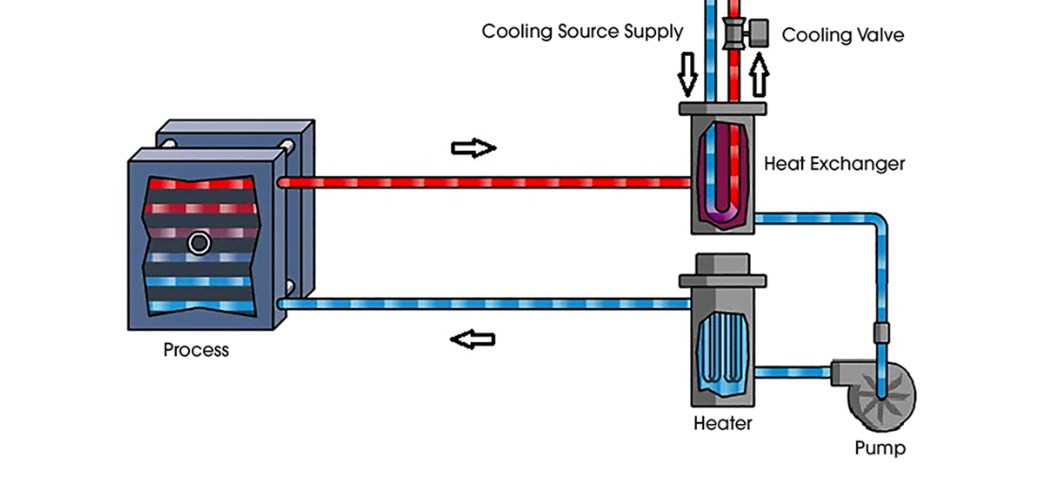

Indirect designs still use a cooling valve, but the process loop’s fluid is isolated from the cooling source fluid with a heat exchanger. The cooling valve controls the flow of the cooling source fluid through the heat exchanger. The warmer fluid transfers energy into the cooling source fluid, thus achieving the required cooling.
There are pros and cons to each cooling style. Direct injection mixes the two fluids, so contamination is a concern. The energy transfer rate is not limited by a physical heat exchanger, however. Indirect cooling maintains separation of the fluids, but it is limited by the capacity of the heat exchanger. There also are implications for the maximum setpoint of the system because of pressurization requirements that make high temperatures possible.
Indirect cooling maintains separation of the fluids, but this method has a more limited flow based on the capacity of the heat exchanger.
